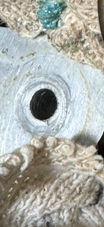

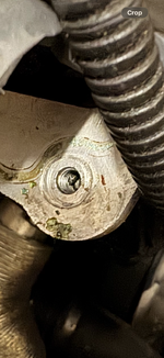

The first few threads must be stripped. When the cover is removed the bolt goes further in the hole engaging the remaining good threads.
I suspect you are correct, a stripped thread. First photo is from the front of the engine and the second photo, whilst difficult to see well, is the problem at the back of the engine. Does this mean cylinder head off to have it sorted?
Should be able to fit a helicoil in there. Any competent garage can do that for you.
Gents, thanks for your help and suggestions. I decided to buy a £20 helicoil kit off Amazon and have a go myself (thank you YouTube). It wasn’t difficult in the end after I worked out what I needed to do. Took 15 mins and it appears to have worked. Did 40 miles mixed driving after putting the cover back on, got home checked, no signs of oil and no burning oil smells so fairly confident that was the issue. Many thanks again and probably saved a bit of cash visiting the garage.
