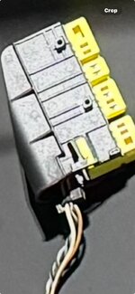

I picked up a set of e46 seats. My 2007 had the standard no thrill seats. Looking at the plugs when removed I don't have the preface lift wiring harness. Mine has 4 wires going into both seat plugs only. The M# seats I picked up are full function. Heat, power, Lumbar and memory. I know someone has done this but I can't locate any guides on here (my error I'm sure in search) A guide and advice on plugs and else needed and where to tap in to build the harness I need would be a great great gift at this point. I've looked all over online but I guess not in the right places. PLEASE HELP if you can.... Thanks

Here you go
