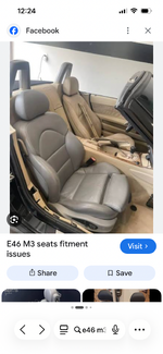

Just found this link with pictures of M3 coupe seats in a Zed….
I’d go E89 personally and the look fits the car better and less wide across the shoulders. Much comfier than the original sports seats too.
Follow to how to on here (just search for it) and it easy enough.
Thanks, it’s very helpful to see the side by side like that. I quite like the way the seat looks there and it looks a lot more comfortable just looking at the shoulder area
