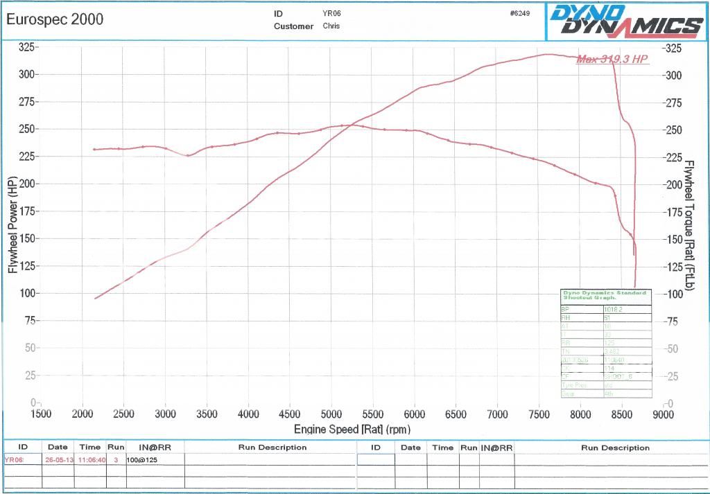

Here is the main result page (1/3)
Max Power 319.3 HP
At the wheel 264.3 HP
The torque line looks very flat and I'm also very pleased with how smooth the power delivery curve is. The max torque figure looks to be around 255 lb-ft which translates to 345nm
In all cases I appear to be a good smidge below the OEM figures which are 338 (or 342 depending on where you look) BHP and 365 Nm 269 lb-ft
Since fitting the supersprint the car is much much MUCH smoother, even in Sport mode the jerky motion you can get from the throttle has really smoothed out.
Conditions wise, it was a warm day on Sunday (18 degrees) and the car usually runs on Tesco 99 and today was no exception.

I call bollocks on the dyno myself, as I don't believe your car revved to 8400rpm - mine hits the limiter at 8000rpm - so if that's wrong, what else is wrong?
The only figure that I'd take away from a dyno would be the wheel HP as everything else is a guesstimate - although the measured RWHP can be manipulated/incorrect depending on tyre pressures, condition of rollers, strapping, etc.
I'm not convinced by the 8,400rpm figure either. The test was run in 4th gear if that makes any odds to the limiter. At the wheel power came out at 264.3 BHP, still seems low to me.......
It's making power too early and max torque too late also. Strange.
Should be making max power at 7900 rpm and max torque at 4900rpm

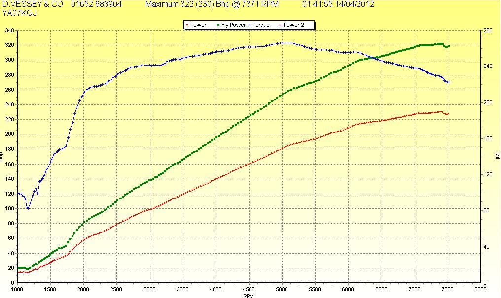

This was my dyno graph, done 12 months ago. The guy only revved it to just under 7,400 though because he reckoned his machine was near its limits. You can see my torque curve looks almost spot on the factory claimed figures.
319hp engine and 264hp at the wheels? That works out at 21% drivetrain loss. Way too much drivetrain loss...
Also don't be dismayed that you didn't post the stock numbers, if the dyno operator wanted to he could've made it show that you had 400 (see drivetrain loss above for example) plus the S54 is known to not post the factory numbers in the first place...

I don't think the RPM plot is accurate. I don't think it goes to 8,400rpm without the limiter kicking in? 7,500 sounds far more like it to me.....
