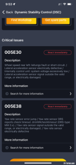

got some new codes flagging up which I cant clear on the 3.0;
005E30 and 005E38
Both seem to be pointing to lateral acceleration circuit and yaw rate sensors
Where are they located so I can have a look at them?
Anyone else got experience of these codes and how to sort?

There is a wheel speed sensor plugged into the back of each hub. These are easy to remove and clean, although sometimes it is the reluctor ring that has corroded inside the hub.
The yaw sensor is located under the carpet, square under the driver’s seat. Sometimes these end up sitting in a pool of water and terminals corrode. It’s a seat-out job to to have a look at it and a new one is expensive.
What diagnostic system are you using?
I've got carly and a basic reader- I'll get the carpet up for a look
Thanks for the location guide, I'll check the sensors too as had to replace fronts, however codes USUALLY reset when it was a wheel sensor
One for after Xmas
