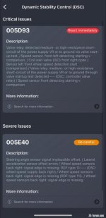

I have read the codes and searched so found that it looks like someone fixed it with a cheap abs sensor (don’t know where that is yet but that is the next step).
Resetting the code just comes back straight away after going into second gear so me hoping that a low battery might have caused it seems unlikely.
What is the opinion re the below please :788328F4-47D3-4CD0-BADD-E00564A505FD.jpeg
So that is pointing to both front left and rear right wheel ABS sensors being dodgy.
However, am I right in thinking yours is a facelift? If so, it is also worth checking the yaw sensor (lateral acceleration sensor in your second pic). People have been known to replace them with a much cheaper pre-facelift version which can cause all kinds of weird symptoms.
Should be able to get at it by unbolting the drivers seat and carefully tilting it without disconnecting the electrical plug, to give room to look under the carpet. It sits under a bracket on the rear of a cross-member just in front of the carpet join. If it is a black plastic one you're fine, but if its a silver metal one its a pre-facelift.

In isolation it seems the wheel sensors are at fault, but I confess all the talk of 'valve relay' has me lost. (Better to admit my shortcomings than lead you up the wrong route)
My suggestion would be to speak to [ref]colb[/ref], as I'm pretty sure he is more educated on this system than I am. At the very least he has more practice than me in interpreting the code readers.
I think (Carly can be good and bad at this) your second code is one I’ve seen before
It’s a mismatch between your steering angle sensor and the data from the yaw sensor
It’s worth resetting your sas using the procedure first outlined by zedebee …
I’ll find the link, using inpa and sys32
Stuart

First step would be to change out the wheel speed sensors that are reporting as error codes, since the vehicle has been stood for a longish period would be prudent to pull the sensors out and see if the reculter ring it takes its reading from are clean and rust free.
I would agree as already mentioned to realign the Yaw sensor uising INPA or another scanner capable of doing it.

At the moment, I only have a Carly. Is that capable or do I need to get another scanner?
Not sure if Carley can do it, INPA and BMW Scanner 1.4 on a laptop can.
Up marklet Diagnostic Tablets like Autel and Launch can do iot as well as code replacement modules but they come in at a hefty price.
