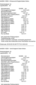

As far as error codes go, I have 5DD2 & 5DD0 permanently there.
