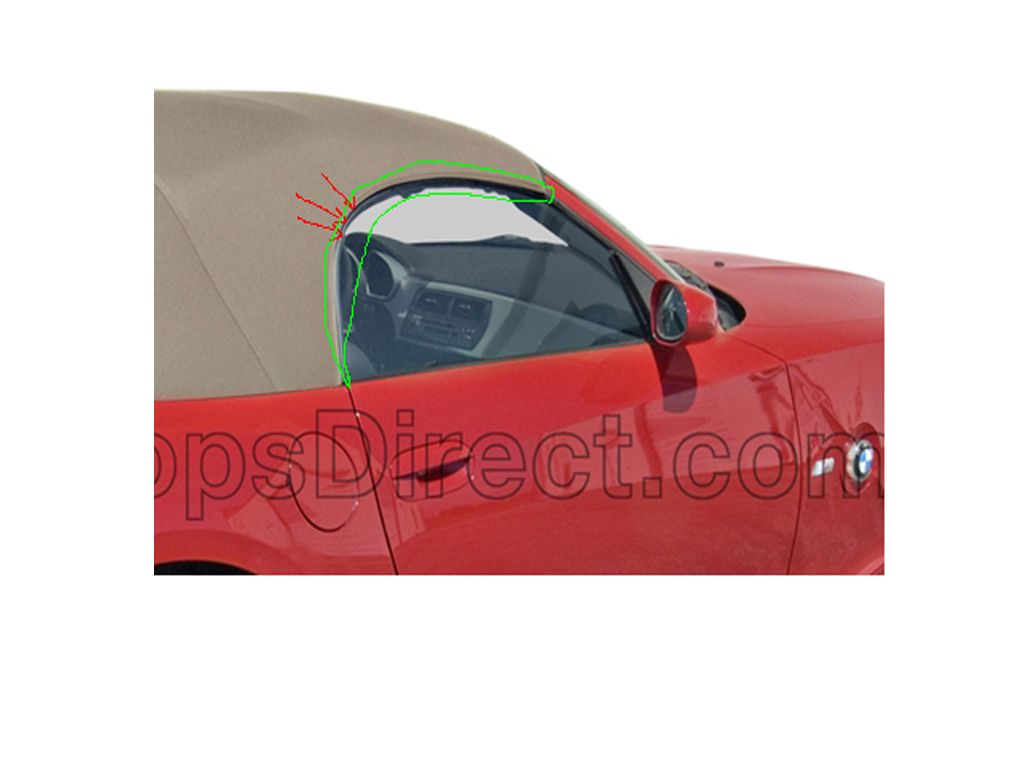

Well done!thorpyuk said:Did it last night - real easy, drivers door is now flush with the bodyAlso has reduced cabin noise to boot, so well chuffed! Great tip!
bcworkz said:![]()
Move plate slightly towards centre of car if rear door edge is proud of rear wing. Best to mark original position so you know exactly how much you've moved it and can restore original position should problems arise.
