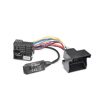

One of those Bluetooth adapters is probably next on my list for my 2003 E85. Which one did you get? I've seen a few on Amazon, and some with hands free mic which might be handy.
As I understand it, the vents have two metal clips along the top that needs to be released through the vent grilles somehow?

Yeah, the vent has two clips on the top and two on the bottom. I used this guide to remove it: https://youtu.be/tuBuSuzJxho?si=-MJP9SPor8aUCIDz
The adapter I got was from ebay. Worked just fine, seems to connect to the phone quickly, the sound quality is good and it also seems to turn off when the car is turned off, so it hopefully won't drain the battery, which was a worry I had.

Thanks for that, really very helpful. That YouTube video is great, good find 👍
Time to order one of those adapters I think.

Edit: I have to remember to remove my FM transmitter from the cigarette lighter as that remains powered when the car is off.

I tried and failed with the air vent removal. I think I found the clips, but nothing would move the vent out. I was worried I'd break one of the vent grilles in the process, so decided to take a break (ahem) from it. Perhaps finding the CD changer leads behind the centre console might be a less damaging route to take. Is the vent itself a very stiff interference fit into the dashboard? It felt solidly stuck in there even with the clips released. At least I think they were released!

Yes, I'd say the vent is a stiff interference fit. It took me an hour of fighting to get it out. My tip is to get 3-4 thin screwdrivers and special plastic clip removal tools and to try again.

Thanks. Im going to revisit when I have some time to carefully work it out. Never had a stereo so tricky to remove from a car before.

Finally had another go at this without success. Oddly the bottom of the vent appeared to release but the top refused to budge. Being concerned I was near the point of damaging the vent fins I gave up.
Ten minutes later I'd found the two cd changer connectors in the boot lol. I should have done that in the first place.
Now to order the correct Bluetooth adaptor for the boot connection....
