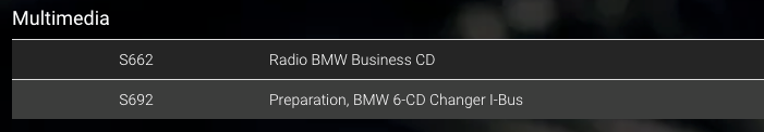

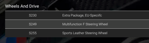

First of all, do I even have it?
Here is the picture of the steering wheel and radio.
Here is the list of equipment from the factory
If I have bluetooth, any suggestions on how to set it up will be appreciated.
I know there is a lot of content on this but I haven't found any solution that works. Simply, nothing happens. :headbang:
Car is not displayed in the list of available devices, nothing displays on radio, no instructions in the user manual.
It makes no sense to me to put a steering wheel with bluetooth buttons if I don't have bluetooth :D
Hmm, I remember that I checked if that existed and it doesn't.
Then I probably don't have it.

Might seem a bit daft but there is only one version of Multifunction Steering Wheel so it works for the stereo only, although it would control Bluetooth too if you had it.
Thanks for answers! I googled about buttons on the wheel and no bluetooth and it seems BMW did that for other models too.
In the centre fold down cubby between the seats if there's a button there with the same image as the one on the steering wheel thats what you use to set bt up , if no button below there no bt
