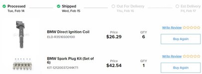

Mine arrives in a few min from FCP Euro.. Don't forget coils... they need love too.
So the coils need changing at what mileage, 2.5, changing my plugs but hadn’t considered coils but I’d expect them to last at least 80k?
