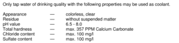

BMW say tap water???
Hadn't seen this but living in a very hard water area the only stuff I trust has been through the dehumidifier first - I filter drinking water but wouldn't put that in the cars!
Does seem like over kill this. Especially in soft water areas like the North West of England for example. Plus I know for a fact that virtually all garages whether they're main dealer or back street just use tap water.

Yep complete overkill. Totally pointless even BMW use tap water. Their spec listed above of 360ppm is twice the UK's very hard water at circa 180ppm. So why bother wasting even a little money? I certainly wouldn't wait to top up coolant or do a change till I got my hands on some.
365ppm in my location - I'm still for avoiding tap water.
