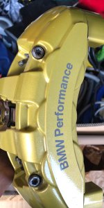

E90 BMW performance kit bolts straight on to an e89. It'd be a nice upgrade. 34110444738

Just put one on my E89....nice piece of kit.

Be aware that the European Z4 35i has larger brake discs as standard than the E90 performance kit. In the eyes of the law, this is considered a downgrade and is therefore illegal.
For a, 30i or any of the 4 cylinder cars, you'd be fine.
On a 35i or 35is the only direct upgrade are the calipers used on the 440i/340i as well as the M4/3/2 along with 370mm discs.

Picked these up second hand having only covered 3k miles, only thing I had to get was a brake sensor as this is different on the E90 range. My car is an N20 so a big upgrade for my car

The 135i (aka the yellow ones above) 6-pot setup is quite difficult to get hold of (second hand).
The F30 4-pot Brembo setup also fits and is much easier to find.
