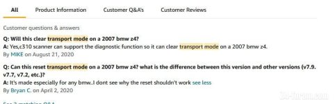

Thanks Colb. I looked at the scanner you recommended and in the FAQ found this:
So, at least somebody believes that it can be done. I also checked the other scanner I was looking at and that one clearly says it cannot do it, so I decided that, this tool being US$56, it would be about the same price that BMW Colombia will charge me just to put their scanner on, without doing anything else. So I ordered it and I will try to correct the transport mode problem.

Well looks like the Creator 310+ will do it, can't remember seeing it in the options on mine but most probably capable of doing it if it says it can. The 310+ is well worth getting for access to all the other modules on the car far more portable than the laptop systems. As you say you would recoup the cost of the scanner first time you use it rather than pay a garage to do it.
