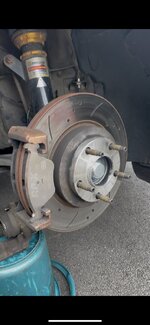

Well.....the Volve part didn't work :thumbsdown:
Can you spot the difference? Volvo top, Z4 bottom
54277126099_1383e97171_b.jpgUntitled by Damien Bower, on Flickr
So, I managed to find one from a 3 Series using the part numbers in the thread i linked above, this one looks more promising
54277306075_99dbbd9411_b.jpgUntitled by Damien Bower, on Flickr
Just need to bleed the brakes now and give it death :driving:
If you have curved brake cooling fins rather than radial it looks like your brake discs are on the wrong way around. If the vanes are curved then facing forwards will be trying to force air inwards which will not help cooling, rather the opposite. If they are radial then it makes no difference so I'll shut up.
They are straight vanes, not curved

Also, I'd had trouble sourcing some RP-X pads for the 3.0si, after much research, it appeared that E46 M3/Z4M pads were very very similar shape, so I took the plunge and ordered some. They fit perfectly. However, the lack of clip on the piston side means the pad rattle in normal driving is unbearable!! It really sounds like the car is actually broken! So I'll use some road pads for normal driving from now on and swap to the RP-X if they are as good as I remember.
54481938028_bdc85982a4_b.jpgUntitled by Damien Bower, on Flickr
Managed to source some 17 inch wheels too, along with a full set of 235/45r17 Direzza's. Very excited to try these tyres and a square setup.
