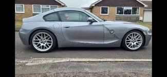

Im running 18" Avus AC-MB4 CSL reps, similar to the Rivas but the rears are 9 inch wide so extra dish. Here is my car on eibachs and bilstein b4.

I’ve found this image online and really liked the look… these look 18’s to me..
Thanks in advance

But, whenever I put my 18" track wheels on, I actually think the car looks much better. The bigger sidewalls and smaller wheels I think suits the car better and if I had the money I'd buy some Apex 18's for my everyday wheel, probably will do that in the future tbh!
(Those wheel's in the pic above are Apex 18's I believe (Arc-8?), kinda proves my point and agree!).

Found these..
Are these them ?
Adam
I would go on Apex's website which is very good and gives you all the different offset options for the car as well. Believe they are also pretty helpful via. email if you need help: Apex
They will ship to UK I believe but there are plenty of UK resellers, sure someone else can help you with a good one if you prefer that option as I've not actually had to look into that side of it.
Arc-8's are their CSL style rep and look excellent in my opinion but they have other options. Expensive, but your getting a very good and well made wheel IMO unlike most rep's which are on the cheaper end (including the Stroms I have).
My personal choice would be 18x9 on the front 18x10 on the back for a nice aggressive look. Might be worth asking them what camber you need to run to make sure don't rub though as obviously wider than standard.
