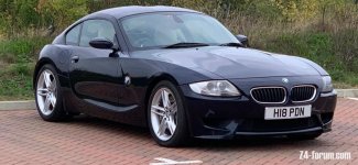

I’ve just bought a Z4M coupe and I’m looking at adding some CSL 19s on the car. I see that CM Wheels offer a good replica.
Can someone advise what size wheels I need, whether the fit straight on or if I need spacers etc and lastly..... what size and brand tyre do you recommend? Cheers Ben

My M Coupe came with 19" CSL Replicas already fitted that are the exact same sizes as genuine ones and they fit just fine without needing spacers. Although the previous owner had spacers on it anyway. But because they were rubbing I got the spacers off!
Anyway the sizes are 8.5J x 19 fronts with an ET (offset) of 44 and 9.5J x 19 rears with an ET of 27. My tyres are Michelin Pilot Super Sport which grip fantastically, but not so well in the cold and damp and are no longer available. I think the current alternative is Michelin Pilot Sport 4, which another owner rated better in poor weather conditions. Fronts are 235/35 and rears are 265/30. I've no experience of any other brands, although obviously there are plenty of alternatives.
