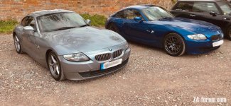

Ive spent hours lurking on the forums and now its time to start my own project thread. Mine is on the left parked against another which was a totally random spot at caffeine and machine, anyone on here?
One of my front top mounts has a crack in it so this has provoked a bit of a suspension refresh :roll:

What a fine pair. :thumbsup: Unusual and lovely colour on the right there. 8)
Enjoy your project and keep us nosey lot posted. :wink:
