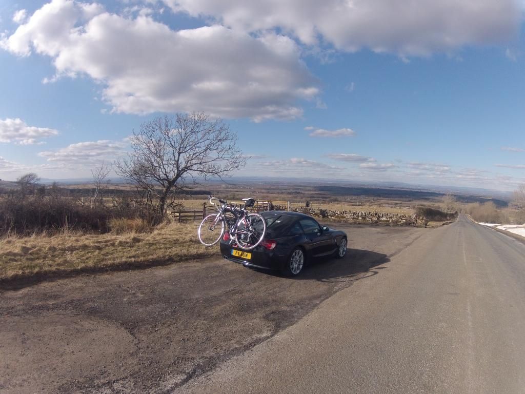

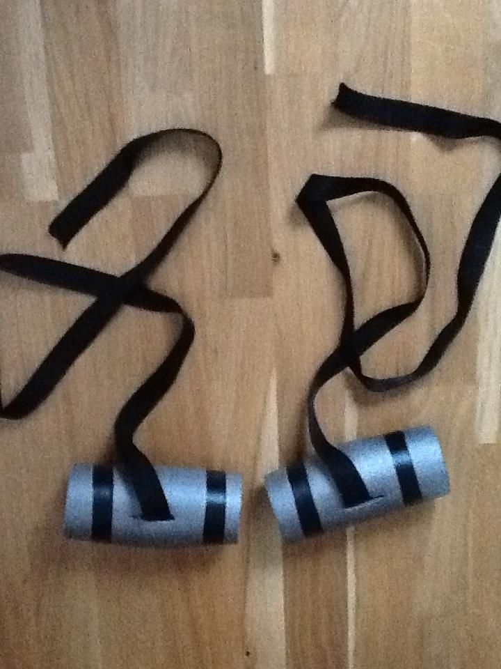

I have just bought the bones 3 as shown on the pic. Great piece of kit and very secure and easy to fit. Dont buy the hatch huggers make them yourself, really easy. All you need is 2 x 4" lengths of wood dowel, i used pieces from an old broom handle, buy 2 black ratchet straps from Wilko's which are a few pounds at the most. Strap the ratchet straps round the dowel and then get some water pipe lagging, the good thick stuff for 32mm pipe. Cut a 1" slit in the middle of the lagging opposite the split that is already there and feed the strap through the 1" slit and then push the lagging round the dowel, then just tape up with duck tape either side of the slit where the strap feeds through and your sorted. I've used mine 3 times already and they do the job just fine. I could'nt bring myself to pay £15 for something that is easily made for a few pounds.
By the way, i bought my bones new off a trader on e-bay for £114. Some second hand bones 2 were going for £90 + so thought it made sense to go for new. Honestly, its the best rear end bike carrier out there.
