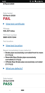

No idea, MOT was done prior to sale of the car to me. Fail report says the following so I'm assuming so.
