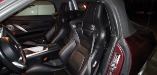

Thanks. The seat swap was pretty straight forward. Braum has precision fit mounting brackets and a hardware kit. I recommend ordering everything through Vivid Racing via phone call (same price as ordering from Braum directly). The operators can help make sure you have everything you need. I actually paid my mechanic $80 (local full service Midas shop) to do it for me since I was having some other work done, and I have some significant back issues, but it is a very easy straight forward installation.
Be careful removing the old seats, they are very heavy.
It's pretty much taking out the 4 bolts that mount the seat to the floor and the bolt that attracts the seat belt buckle, put the new seat and brackets in and put the new bolts in and you are done.
Note: You will have an airbag light since there is no longer a connection to a pressure occupancy sensor. To fix this you need to take the car to a shop that has the BMW software and get a bypass programmed to the computer. This took me a while and a lot of research to figure out.
I will try to post more pics of the seats soon. I can't open the top at the moment, because I am replacing a power window regulator and the automatic top rolls down the windows before pulling the top back. Hopefully my new regulator will be here soon. (coming from Germany)
