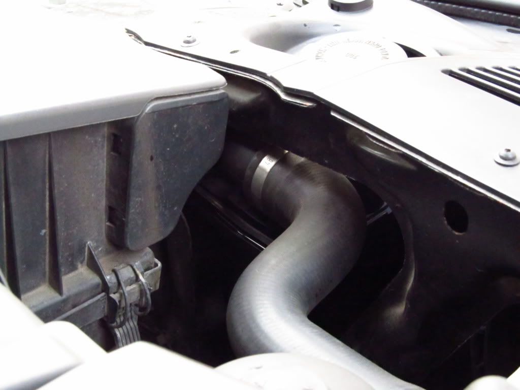

I've put on a photo-the water was coming from just below the metal band.

Im pretty sure it isn't the aircon, its coming from below a radiator hose.

My mate has been over to check it over and he is going with the numpty theory that I hadn't tightened the cap enough as it has to hold 1.4lb of pressure and unless absolutely tight, it wouldn't and would leak.
The other thing he pointed out is that the radiator hose next to the filler that I thought may be split is actually the water to engine intley not return which makes sense as the hot water would be at the top.
