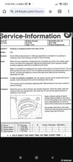

Thanks. I'm pasting a link to your original post to help anyone else with the same issue. https://z4-forum.com/forum/viewtopic.php?t=129915
On the BMW fix that you found, it mentions putting the car on a lift so the wheels hang down. Then cleaning the upper coils and rubber mounts with a dry rag. Before applying talcum powder. Is it possible to see if the S21 lettering is facing outboard without removing the springs?
If the lettering is facing the correct way I guess the garage should be able to do this without removing and refitting the coil springs?

(As I posted at the time.)

The car was back at the garage yesterday for them.to.try and fix the problem. I took in the forum members recommendations with the BMW suggested fix. They turned the new coil springs so that the lettering/numbering faced outboard. And cleaned them before using a specialist auto grease. That they told me would be fine on the springs and rubber mounts.
Like you, they thought that talc would wash off so didn't use that.
