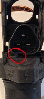

Afternoon all, having a problem sourcing coil packs for my 3.0si. Ordered some from ECP but the arrived with a central tab where the ones on mine are to the left(pic of mine attached). GSF were the same, went into ECP and really helpful lad on the counter ran the part number from which came back as the ones with the centre tab. Does anyone know where I can get replacements, I've checked all sites but none of them show a clear pic of that small plastic tab

Firstly, I accept you want the proper items:
HJowever, given the shape of the plug, does the tab actually achieve anything? Could it be removed?

The plug has a slot in it which won't allow it to engage as the tab on the replacement is in a central position. Didn't want to cut out the tab as I'm thinking there must be variations in the coil packs hence the protective tabs

Looks like @RobbiZ4, and BMW themselves, have a similar solution.

I see what you have done there but wasn't sure about removing the tab. May be easier to slice out the tab with a new Stanley blade than risk messing with a 20 year old plug

Thanks for all the replies, got this sorted now.
The lad from ECP did eventually find on with the tab in the right place but I had already sorted it with advice from here.
I didn't fancy messing with the old plugs so I took a sharp chisel to the coil pack itself and removed the tab. Slotted pack in to place great and now running fine again
