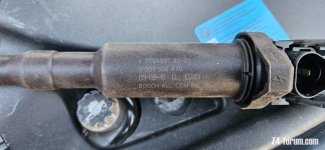

I have just had a look at the ignition coils and what's currently fitted (BOSCH 0221504470), after an internet search, seems not to be compatible with the E89!?
As you can see in the photo, judging by the production date, these probably have been there for a while. I have read online that the dates go in YY-MM-DD format (but that was in a USA forum) so I am not sure if the production date shown is september 2016 or september 2009 (my car is a 2009). Could anyone confirm, please?
At least all ignition coils are the same (ie: the same part number), even if apparently it's the wrong part number.
Having a look in Autodoc, the one that truly matches the part number they gave me at BMW is the Delphi GN10571-12B1. Which exactly matches the BMW OE part number: 12138616153. It's only £22,37. All 6 would be £134,52.
At BMW they quoted me £57.04 + VAT for exactly the same part (I thought they had told me £80 something).
