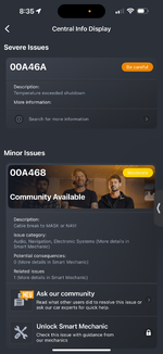

After filling up gas earlier today, I got into my Z and noticed that I had yellow lights on the dash. I have one picture, but shortly after the ABS light and DTC light came on and were yellow:

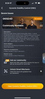

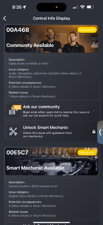

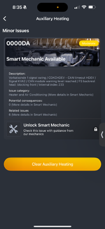

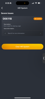

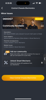

I had my Carly plugged in and pulled the codes (pre DTC and ABS because it was in the middle of clearing the codes), this is what I got the image above:
After clearing the codes I then drove the car home and none of the lights showed up.

If these have cleared and not retired then it may be an intermittent issue with your steering angle sensor
Your yellow oil light is low oil level
I've had this. The stored value for steering wheel centrepoint is off by a few degrees but just within the threshold it will happily operate in. Every now and then the system will think that it's just outside the threshold and throw the lights (gets worse as tyres wear etc or if the tracking slips a bit.)
INPA can display the steering angle value and it'll probably say it's at a few degrees when centred. I can't remember how to reset the offset - I think it needs Tool32.

Ross at RBM reset the steering angle sensor and cleared the codes, but I don't know what software he used. :rolleyes:
