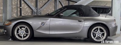

I've had the car a couple of years and I always thought the rear looked too high, looking at the MOT history it failed for a snapped near side spring and I am wondering if the wrong springs were fitted (presuming they replaced both). I don't want to go down the route of coilovers or lowering springs if buying some OEM rear springs will cure it, but I have no frame of reference to check against.
What's the Forums opinion? (Yes I know the disks are rusty, I've not used the car over the winter :) )
Oh and it is a Sport, not an SE.

Seems a fair bet you don’t have the shorter sports springs on the rear. Good news is they are a very simple swap.
Well, thats confirmed then, new set of OEM springs it is. Looking at Autodoc and EuroCarParts I presume I want the "with M technology" version? or is that for the Z4M...? would the normal 3.0si be "with sports suspension".

That definitely isn't sitting right at the back, so probably does have SE rear springs.
My 3.0Si Sport looked like this.
