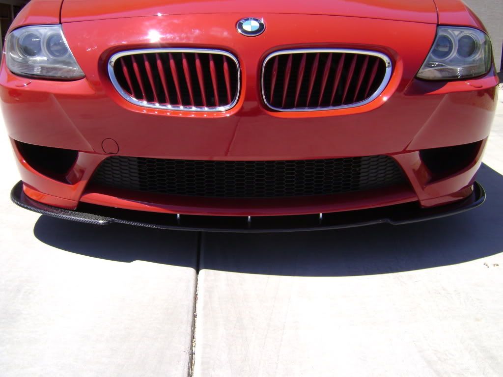

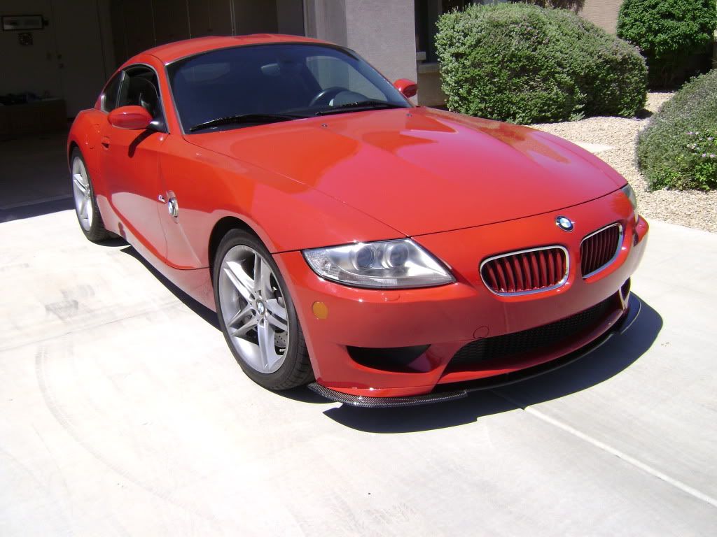

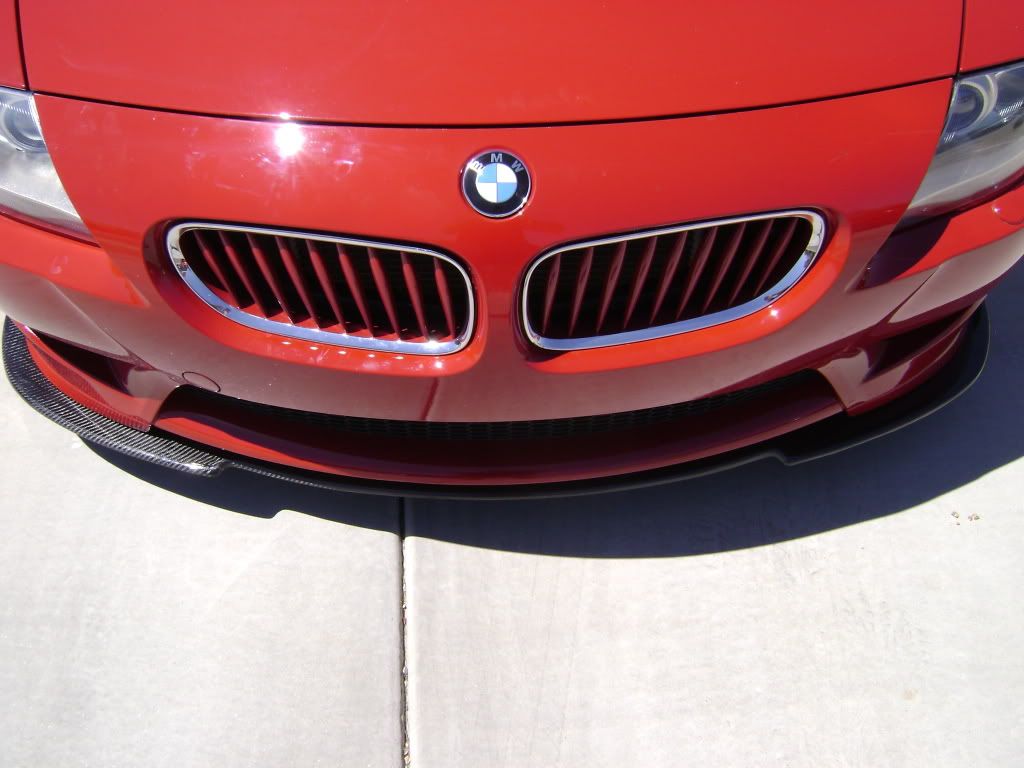

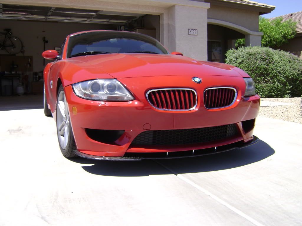

I purchased and installed the JL Motoring CF front splitter today.

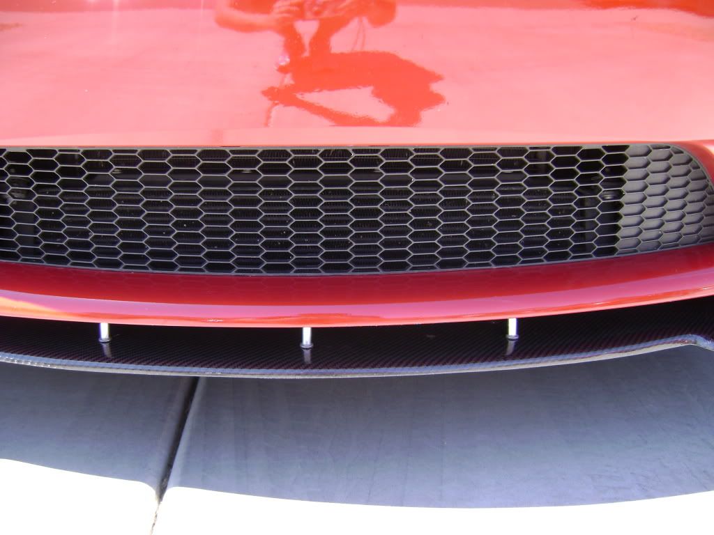

I initially was a little worried about fit and finish but in the end I think it looks good. The mounting hardware that came with it was useless. I drilled holes and used machine screws, washers and lock nuts to fasten. The center span was unsupported so I used longer bolts and some aluminum tubing lengths to provide the support needed and think it came out ok.
