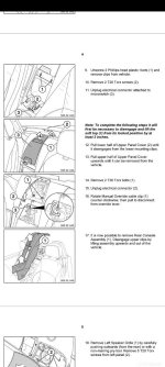

Easy enough to get to without having to take the central console apart?
No Stuart you'll have to remove the top part of the console as per this:
