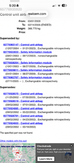

My E85 has had fluid ingress and isn't working. We've bought two second hand ones that were exactly the same. The part number is 65776935920. Has anyone any suggestions to a repair company or if anyone has a working module I'd be forever in your dept!
