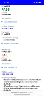

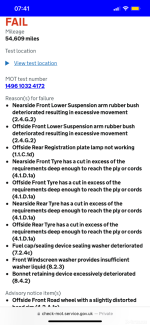

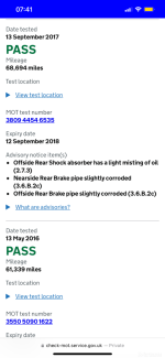

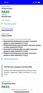

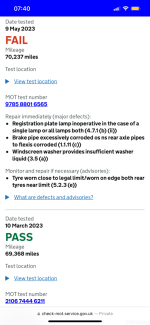

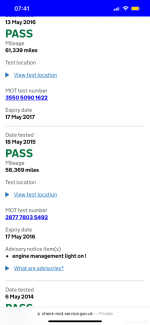

I’m very much loving the look of a 2007 Z4 3.0 Si conv with 75k miles on the clock. One thing that worries me is the apart from this year there hasn’t been an MOT for 5 years ( I guess off the road ) but are there any worries with this? I’m going to take a reader with me, is there anything I should be particularly checking in sun menus etc??
Also I’m not sure if the MOT checker has been a bit OTT or should I be worrying about previous MOT advisories as they’ve had noisy gearbox a long time ago, but not been mentioned since, but the checker had also snagged daft things like bonnet catch or fuel filler seal etc (see pics).

Sounds like the brake pipes have been rotting for years and the previous owner has tried getting out of doing them. Use it as a haggling point if the rest of the car looks good.
Old MoTs are useful to see faults that never go away but some garages will see and some won't.

Why was it tested in March and May 2023 when the March test said a PASS, tested again 2 month later and failed.
I would say any car this age it's more about are you able to do most repairs and fixes yourself, have the budget, time and equipment?
They all need TLC and repairs doesn't matter about mileage and service history, just the nature of an aging car.
Doesn't read like this has been looked after.... but if your prepared to go through the whole car and fix and sort anything you find, then at the right price it can be worth it.
If it was an untroubled example it would be worth? 8K. maybe .. So make list of all parts to refresh suspension, brakes, tyres, wheel refurb, service items, assume cam cover gasket, serpentine belt, water pump, etc etc etc and work out an offer price to fix it up.
You will easily spend 2-3K if you do all the work yourself on the above list.
Really good to scan the car with a code reader pay particlar attention to airbag faults if they come up and monitor the airbag light on the dash when ignition is turned on and it turns off when the engine is started. If the car has been left sitting for an extended period check for rodent damage to wires under the bonnet. Brake pipes are all replacable but a faff to do if you have the kit to make and bend new pipes, all doable pay atterntion to the rear nearside wheel arch area where the rear pipes emerge from the plastic undertray channel and split to each wheel. The pipes here are exposed and get all the muck from the rear wheel blasted on it over the years. The pipe that passes through the rear subframe to the offside is a fiddle to replace it can be done without dropping the fuel tank by feedong the replacement across with the old pipe removed. Pipes in the front wheel arches also need checking where they are exposed. Flex brakepipes on all four corners are worth upgrading with stainless braided hoses, good kits on ebay to do this. Look for any oil leaks across the engine Cam cover gaskets are prone to leaking on the exhaust side oil drips down onto the exhaust heat sheild and burns off causing smell and smoke in the engine bay. The centre plug well gaskets leak and fill the plug wells with oil. These gaskets go hard with age and heat cycles and is not uncommon. The small gasket between the oil filter housing and the engine block also fail with age, replacement involves taking the alternatour out to get at the oil filter housing bolts, the gasket for this is circa £5 on ebay. Tell tale sign of it leaking is oil down the side of the engine block.
All the suspension ball joints and rubber bushes will need checking, these should show up on a MOT and would be difficult to take a good look at when viewing the car without access to a car lift. If you do buy the car change all fluids as a first jon, engine oil, gearbox and Diff so you know whats in it. Check the roof works and if not already done move the motor/pump to the boot where it can't get drowned from blocked drain holes in the cavity where the factory put it.
