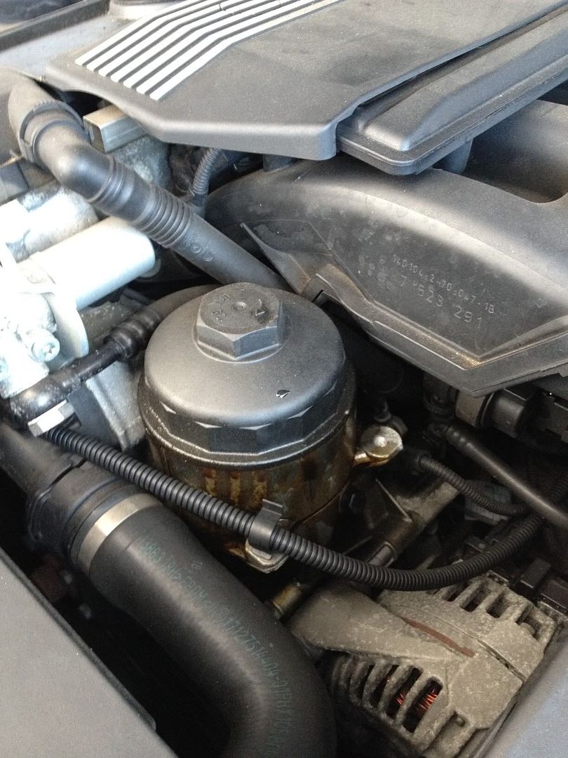

Oh ****, just noticed this...
What is that? I assume it isn't supposed to be leaking oil like that??!
That is the oil filter housing. Can you check if it is tight (by hand). Torque value is on the lid as well.
The battery (not charging) and oil light (low pressure) SHOULD be on with the car ign on pos 2, not running; so that is normal.
Your oil leak isn't normal, and that filter housing needs nipping-up. Low oil may be your issue, if the system is really THAT clever (not something I've ever been aware of, though...but then again I've never run to low oil levels).

Check your oil level and top it up before you do anything. Tighten that oil cap but unless it's soaked everything it's minor and not really part of the problem.
