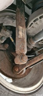

Just going to jump on this. My 2007 M has shocking rear shocks and I want to replace them are B4s a suitable fit:
Auto doc ones
My current ones:

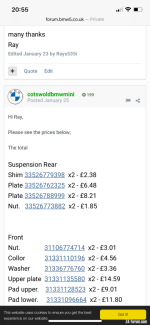

I ordered all new washers and plates from bmw
So I could just get them all built in the shed before putting them on

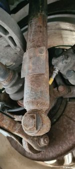

Update
Rears all done ✔️
Front passenger done ✔️
Front driver I hate my car pinch bolt snapped after a good long soak
