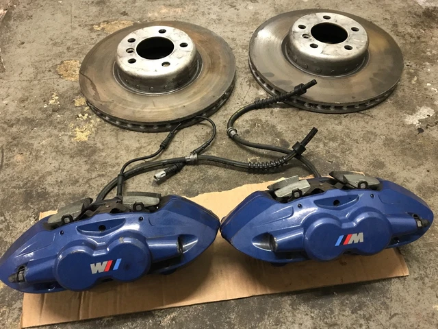

Hello everyone,
I’ve been trying to find clear information about this but haven’t had much luck, so I thought I’d ask here.
Has anyone tried fitting Style 294 wheels over 340 mm discs with 4-piston calipers? I’d really appreciate it if someone could share their experience or confirm what’s needed to make it work.
Thanks in advance for your help, and have a great rest of your day!
I can't see there being any issues as the m140i comes with 18" wheels as standard.
It shouldn't be a problem. My MC has 340mm front discs and 18" wheels, some limited research suggests the E89 35is has 348mm front discs and some of those had 18" wheels.
I've got 312mm discs with Porsche 4 pot calipers under 16 inch wheels, also 356mm discs with Audi 4 pot calipers under 18 inch wheels.
I think you'll be fine, but you could try to get measurements to be sure.
Appreciate everyone's responses!
My main concern is not so much the disk, but the caliper.
They are the blue calipers, as from the M cars, but with 340mm disks.
I have seen a local guy put style 108 on, and they cleared the brakes, but I'm not sure if it has any spacers. Will try to find their contact and ask.
I suspect almost all standard e89 wheels will not be an issue..if you l;ook at the design although the caliper is much wider a fair chunk is on the other side of the disc
