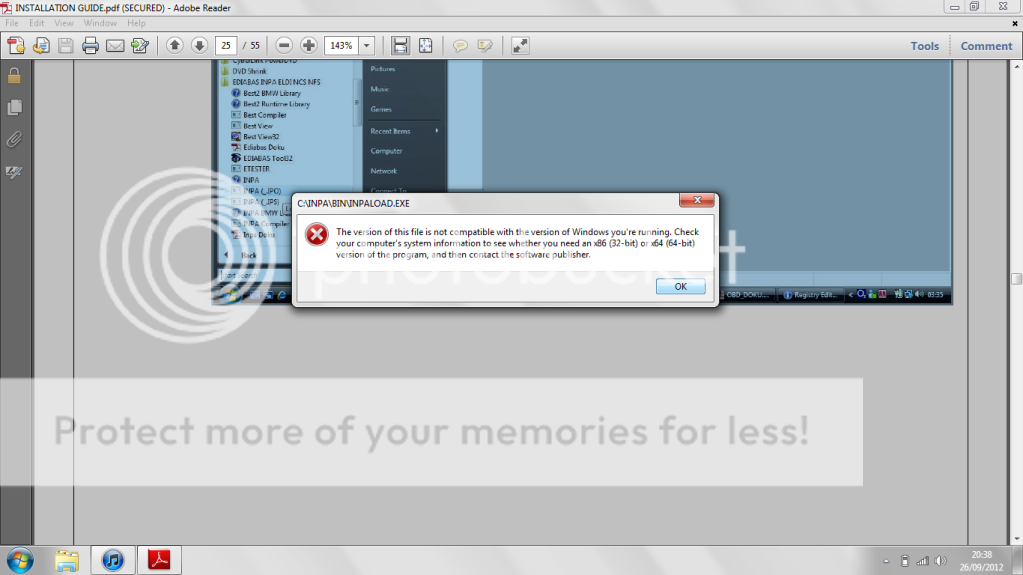

im getting this message. i have no idea what it means or what to do. any help would be great?
My guess is that your laptop is windows 7 64 bit, inpa won't work on this, the best way to install to get all software running in on a windows xp version.
Sent from my iPad using Tapatalk HD
It's possible to get it working on 64bit Win7. There are threads and instructions on the BMW coders website. I found that site after hitting that exact problem and googling for an answer.
Thanks, I've found a guide on the disc but its a bit out of my depth, I'm getting there slowly, at the moment I'm mounting an iso using something called daemon tools? I have no idea what it is but I'm just following the guide the best I can :)
Okay completely out of my depth. Anybody close to the Huntingdon/Peterborough area ill pay £50 to finish the install? Lol
Thanks for that information! And the searching goes on :D ...
