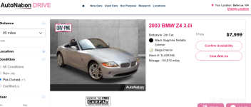

Any pics?
this is the only pic from the dealer. I am checking it out this week and your input is greatly appreciated. I'll make sure I do what you mentioned when I head to the dealership. thanks again.

possibly the worst photo in the world to make any sort of judgement on unfortunately.
If you can copy the chassis number from the window in the windscreen you should be able to find the full specification online.
good luck!
:thumbsup:
also, that photo is used once on the dealer website and doesn't match up to the description or your own mileage description.
Has it listed as Black Sapphire with beige interior and stands at 119k miles. Were you aware of that?
And $8k seems a bit high to me if I'm honest. Does it come with a full warranty?

Good catch. I didn’t even notice that. I emailed the seller/dealer to send me pics. Appreciate it.
