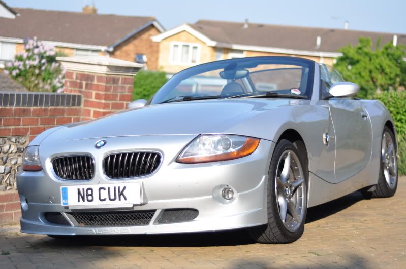

2. I had a set of 108s powdercoated; the main part in a chrome9including rears) that almost looks as though its polished and clear coated. The stars are done in a black/silver metal flake that really pops in the sun. As normal difficult to get the shot. Guys who powdercoated them have just looked into doing wheels, they normally do control cabinets for the military. If anyone wants thier details PM me- they are V reasonable. Note when splitting the stars you will bound to get a few sheared bolts (I had 3, two of which had the heads cut off and glued back to look complete

)it will guide even better. I have as well as two spare stars lots of spare bolts :wink: .

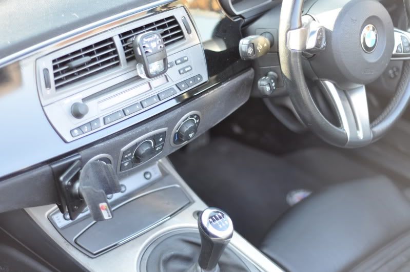

4. Had a cruise switch and cut a spare lower console and fitted that. Good for the long boring trips (v upset there was no indication when cruise is selected :thumbsdown: )

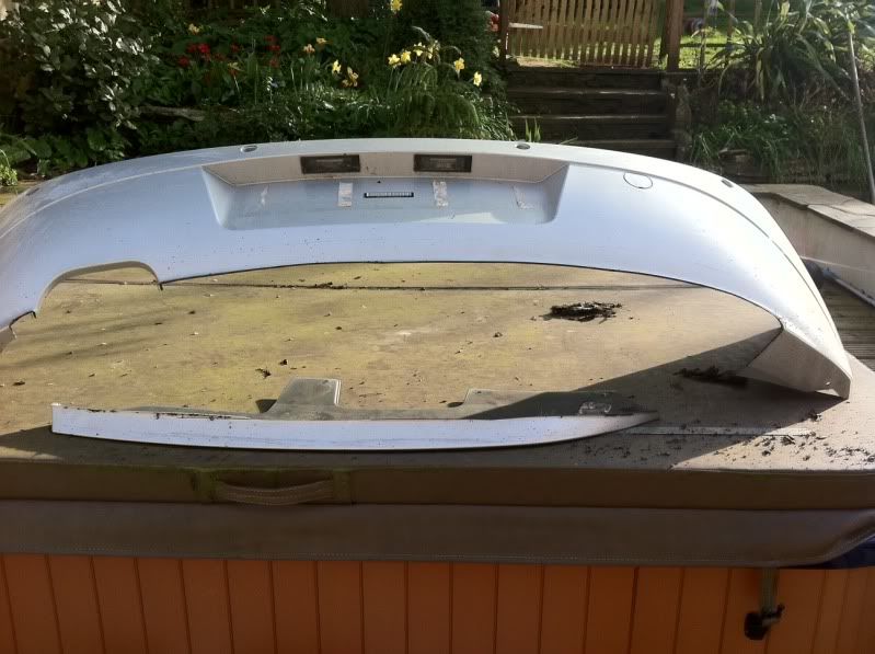

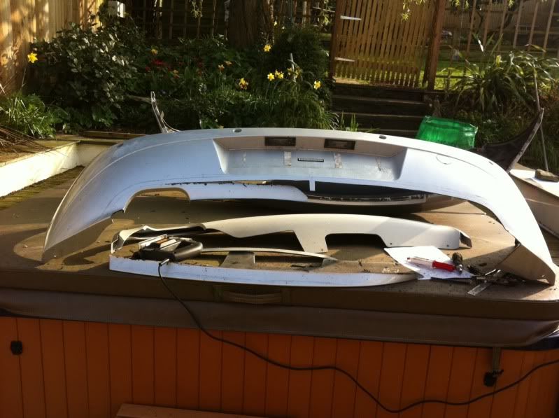

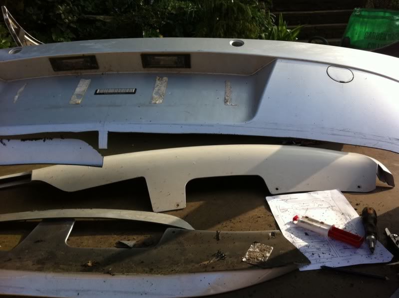

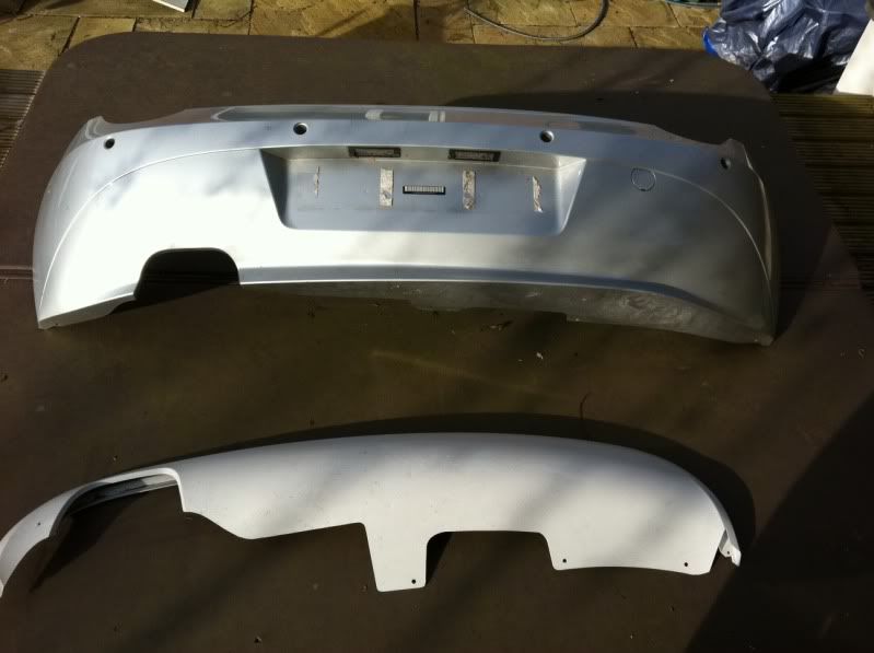

5. Cut up a perfectly good rear bumper and fitted a diffuser I had sprayed up some time ago. I know this is very subjective but I like it and I dont recall seeing one on another Zed (not in real life). Someone sent me the TIS instructions but cant find the email to thank them

), had to change the chrome for mine but I prerfer the contrast on the silver cars.
