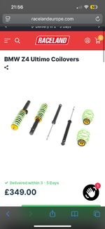

Anybody fitted these? Come with lifetime warranty so I’m intrigued. Yes I know they’re cheap but the car only gets driven in summer and I need a quick suspension replacement.

Not had any experience of those particular coil overs but personally I wouldn’t, cheap is for a reason with these things, they rust, seize up within a year and the springs are usually harsh, rust quickly, snap, etc.
Much much better to drop in some Suplex springs and Bilstein shocks imo.

I want adjustable suspension depending on the wheels I end up getting and I’m fitting wheels spacers. Also, my current set up has shat itself so needs replacing
