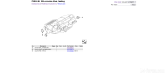

I'm aware these models use an auxiliary motor just for the heater matrix but would I still have even temperature on inlet and outlet if this has failed?
I have read the heater has 'blender' flaps which have been known to cause this but does anyone on here know of this being an issue?
Not sure where the issue lies so anyone's input is appreciated.
I'm able to carry out the motor swap myself and these are relatively inexpensive so may try that first.
