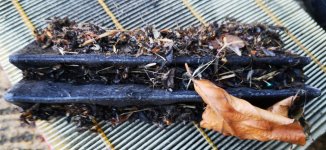

Did a basic service on my wife's '56 plate A4 yesterday. Popped the box open to replace the air filter and was surprised how much detritus was in there. Had the car about six months so first time I'd been in the air box. Then I noticed a pre air filter filter in the ducting that was somewhat clogged....
After Cleaning.....
Before cleaning....
IMG_20190118_185121.jpg.
Can't believe the engine was running! It's a 3.0tdi and it was running fine but seems to be smoother now!
I thought about using it as an air filter. Really can't get over the fact it seemed to have been running okay before hand. Now I'm happy with the oil level after the oil change I'll give it a blast and maybe it'll be dramatically different.
Makes you wonder how much difference these aftermarket air filters make. If this standard one was throttled that much and appeared to be running fine.
