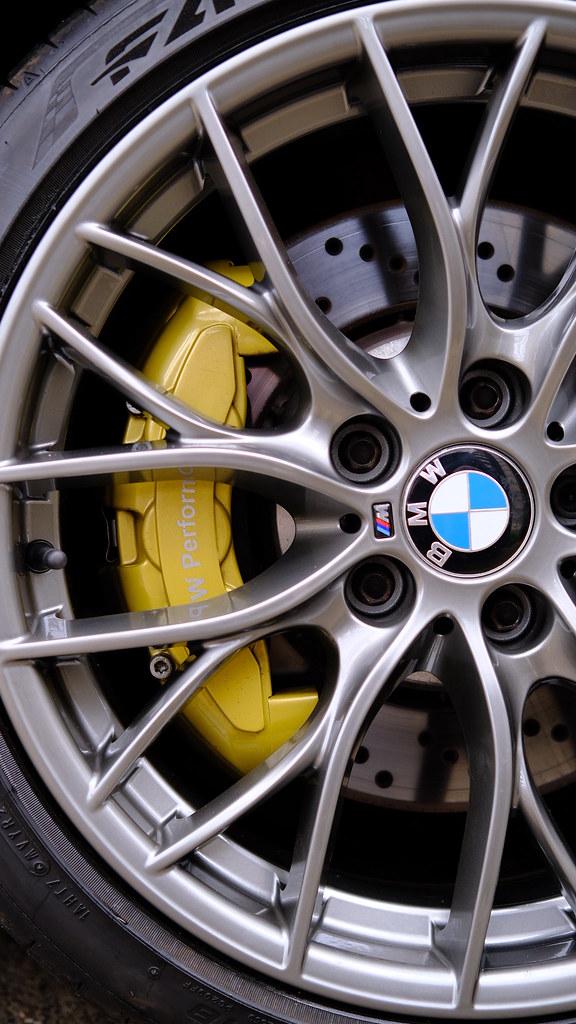

BMW do the performance disc upgrade. Direct replacement, straight on.
Sometimes found on a deal on eBay via Vertu BMW. I have a set, they look great and are lighter too…

Coming from a guy who installed the 135 monstrous 6 pots, DO IT!
Do I notice any performance difference? NO!
Was it worth the cost, time, and general faffery? NO!
Do they look the absolute nuts? OH BOY YES.!
