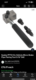

Any recommendations for a flaring tool? Send lots for around £20 like this one https://www.halfords.com/tools/hand-tools/automotive-tools/halfords-brake-pipe-flaring-tool-kit-187982.html

I bought that one and it wasn’t man enough for the steel
I then got a sealey one like this and it’s never let me down
