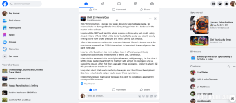

Had some time on this today.
Issue still persists-
Bled (furiously I may add) several times and ABS cleared on inpa
Changed the master cylinder back to the original
Tapped and banged all lines
To be fair there was some residual air in the pipes
However of note- and checked against the coupe and Steve’s m54 z4- there is a hiss sound when pressing the pedal down
I am thinking now that it may be the vacuum servo at fault.
But thanks to all who have helped so far
Still trying to get to 100% with this.
It’s better but not right still.
What’s done:
As above
New fluid
New flexis
New vacuum booster
New master cylinder
I’m still getting softness at the start, which firms up with pedal pumping. If you then leave it 5-10 secs the softness returns
On other cars the pump action makes the pedal hard and it stays hard
The video shows the noises that are heard-
The next step I think is to change the dsc unit… I have one in the shed
Are they all interchangeable (this one is a pre facelift in the spare pile)
Any other ideas?
There are 100% no fluid leaks
Stuart
