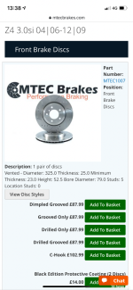

Hi all, after a poor performance on a recent trackday im doing the “easy” brake upgrade, ive sourced the front calipers from a 3.0si and the rears from a 320d, my question is does anyone know if i have to use the z4 3.0si discs or can i use the e46 330 front and 320d rear discs as there seems to be more available and at better prices if you say e46 even though the disc specs look exactly the same? Thanks

Short answer, yes.
Longer answer, the E46 330i and Z4 3.0si use the same caliper carrier, caliper and discs (325x25mm) at the front. Therefore all you need to look for is a disc which is 325x25mm and is compatible with either Z4 3.0si or E46 330i/Ci/d to make sure its the correct offset from the hub.

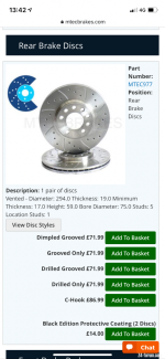

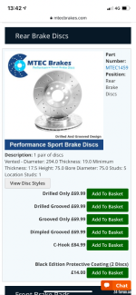

The specs on the fronts look the same but the rears now look like they’re deeper on the e46

Yes that is correct. Despite the Z4 3.0si and E46 320d rear calipers and carriers being the same, the Z4's disc is far more "dished" due to a drive flange (hub) that sticks out further.
