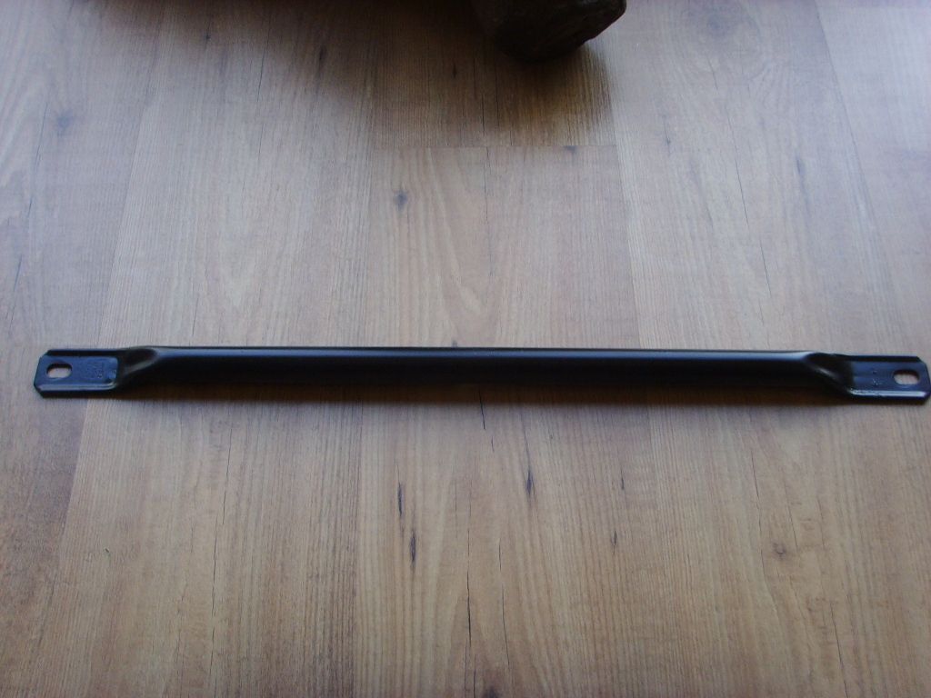

Bored today and running out of jobs to do on the Z whilst the snow clears.
Decided to tidy up my front engine brace struts (I realise it won't be every ones taste.......) they look tidier than they did :)
Before

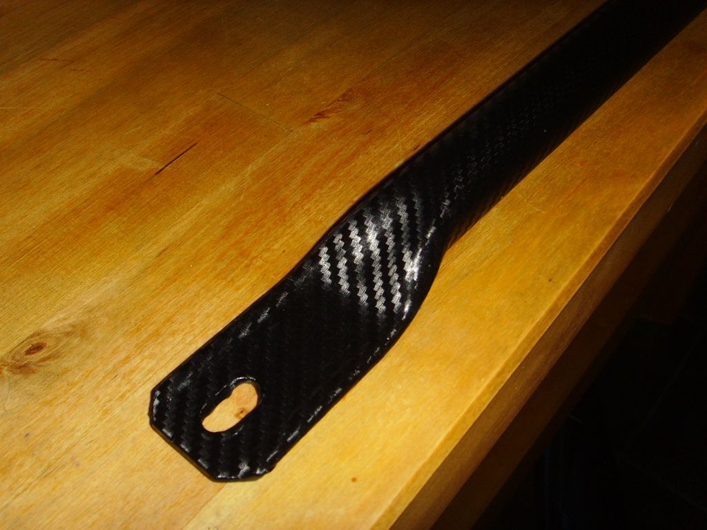

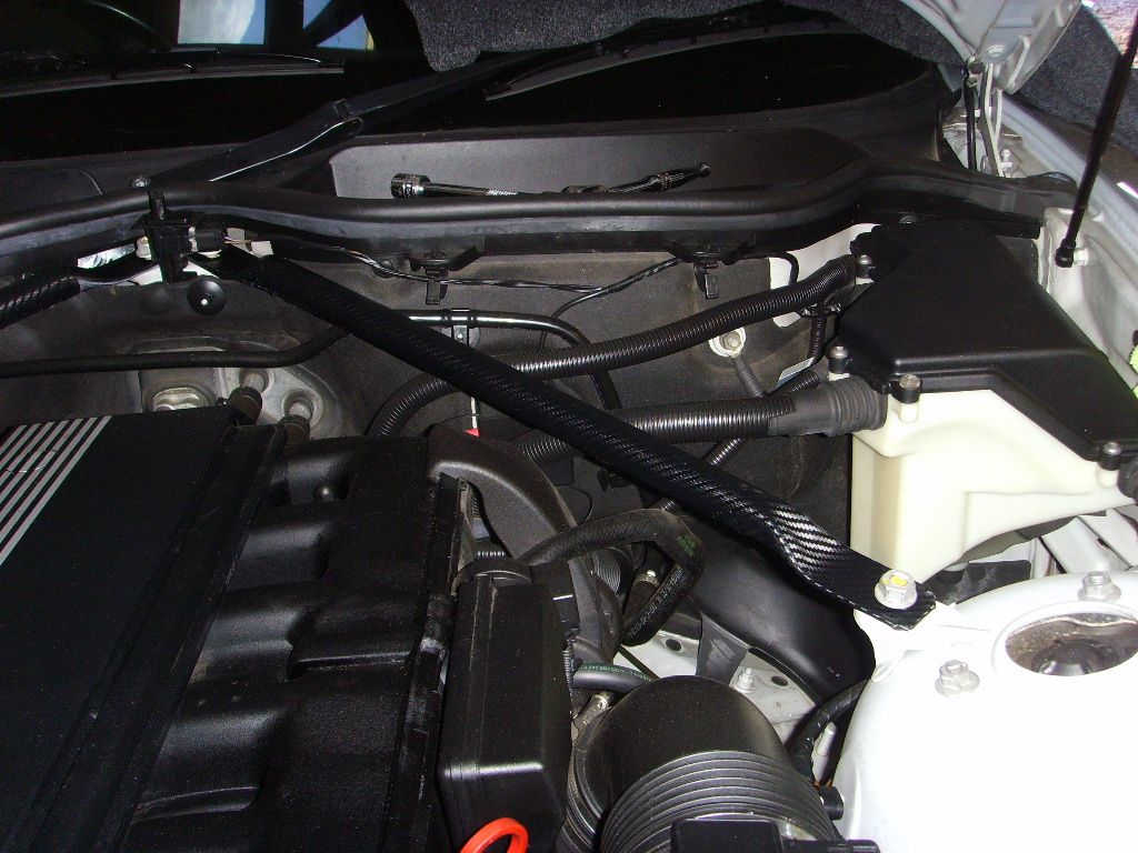

After
Actually, I quite like that :thumbsup:
Be interested in how the heat of the engine affects it, but a nice wee mod !
I will find out in due course. The vinyl wrap likes a bit of heat generally so should be ok..... Fingers X'd
Looks good!
Have you considered giving it a clear coat on top for some extra shine?
I am in the early stages of wrapping....... still getting the hang of it. I never thought of clear lacquer on top.......... may experiment with that.
Tried wrapping a wing mirror the other day..........crashed and burned. :oops:
Toe-side, I've found that getting the material hot enough makes it easier to stretch (mind you I've never used carbon!)
Yes you definitely need heat. There is a 'fine line' when you stretch it under heat as I keep finding. Every thing good...........then.... oops not so good. :( I also seem to always need another hand to manipulate the wrap.
Just a matter of practice and perseverance I guess. There are some great video's on you-tube. They make it look easy!

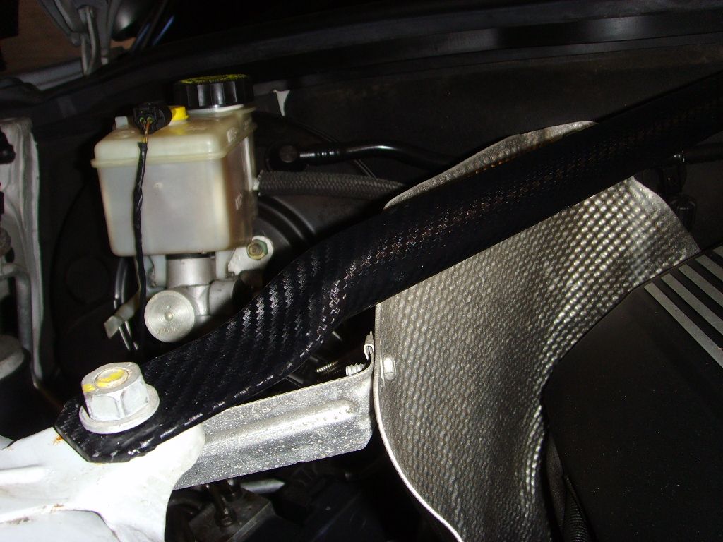

Will the nuts hold those braces as tight with flexible wrap on them as they do with metal-to-metal contact? Those nuts do loosen on their own.
Good point
I cleaned the vinyl off on the underside and added a thin washer on the top to avoid tearing the vinyl (the original nuts also have a built in washer fitted) torqued them down.
Your right though they will need checked as they 'settle down' after some miles applied. :thumbsup:
