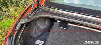

I've post this before, but heres a picture and a video that might help someone with the "top seal" issue. This is showing water ingress coming under the seal. It drops down onto the interior trim and then goes underneath the tool box (left hand side) or electronics (right hand side), without it being obvious its coming in unless you remove the trim from the boot and monitor any water ingress.. take the whole trim off and reseal (I used tiger seal).
https://drive.google.com/file/d/1_ZEG30qHdct8ml9EmOqUp97L4-KhDquA/view?usp=sharing
Busaboyjd said:
I am wondering where you applied the Tiger Seal. Can you post a picture, please?
basically the top seal comes off, there are two torq screws on each side which allow you to completely remove it. then rake out all the old sealant. put back sealant where it came out (basically its all the way along, and particularly on the flat ends). Here's one side
