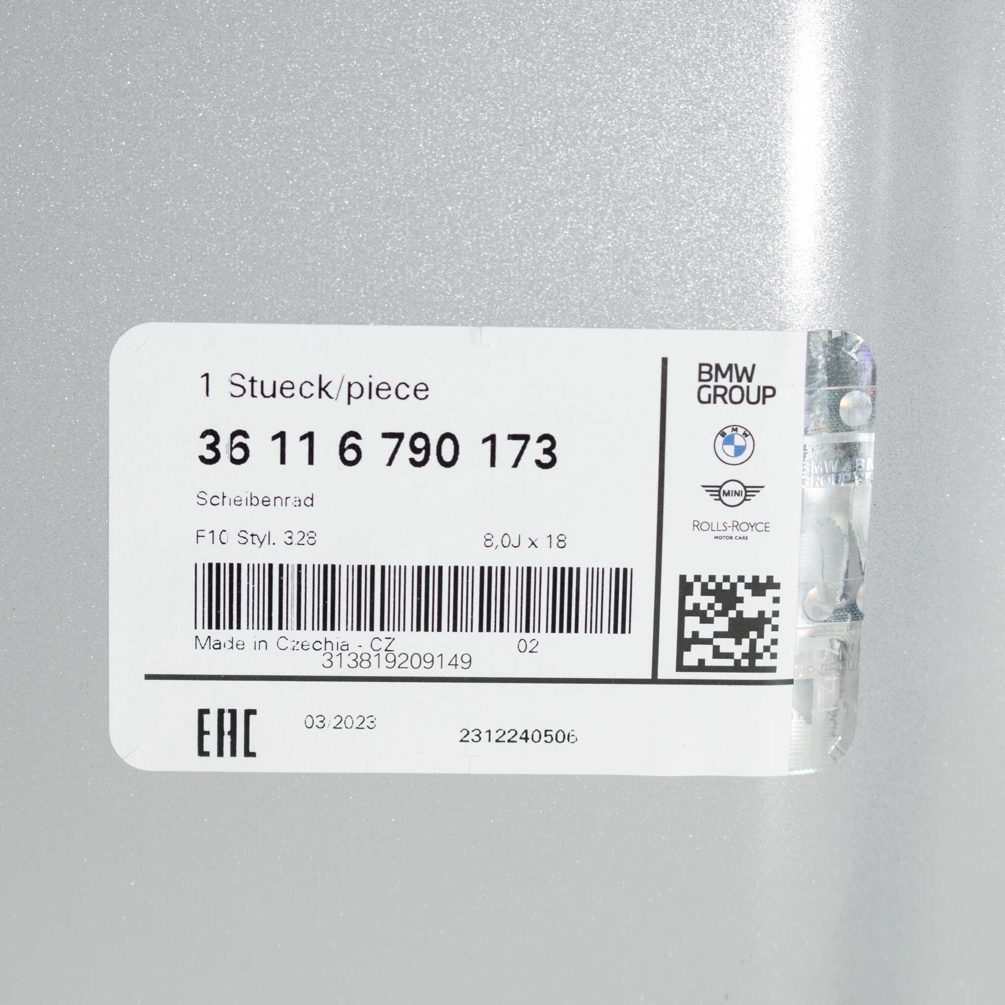

18" square 328s seem to be for the 2011-17 5 series with ET30, so in theory should be pretty similar to running 15mm front and 20mm rear spacers on standard Z4 wheels.
Anyone run 328s on an E86? Anyone got any photos (or better on AI / photoshop than me)?
Thoughts?
