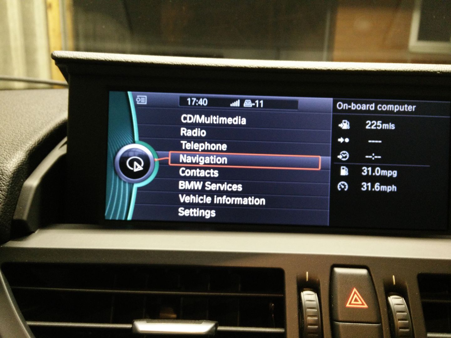

Press ignition

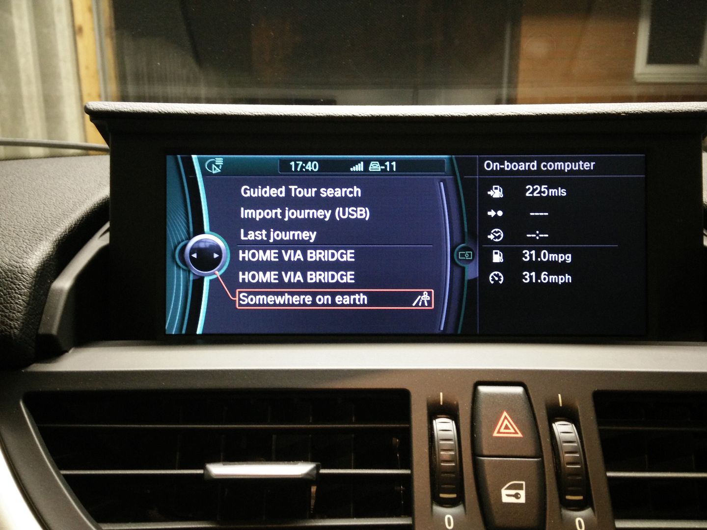

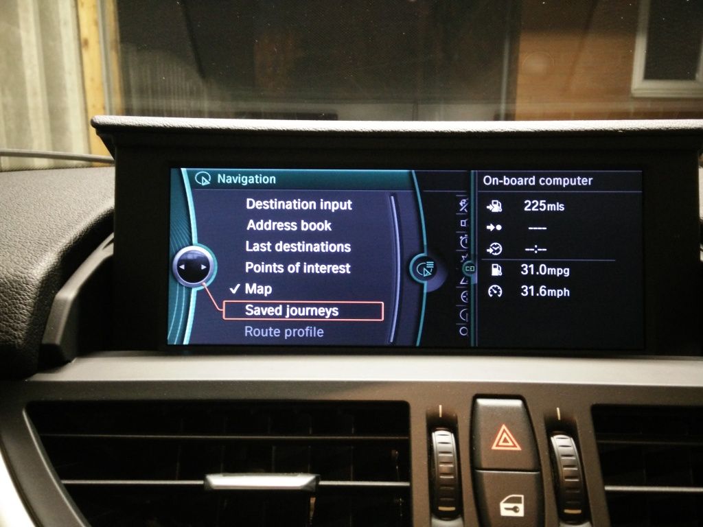

Choose "Navigation" / "Saved Journeys" / "Import Journey USB" / "OK"
On this screen select left on the iDrive control
Select Import Journey USB and then import the file you created

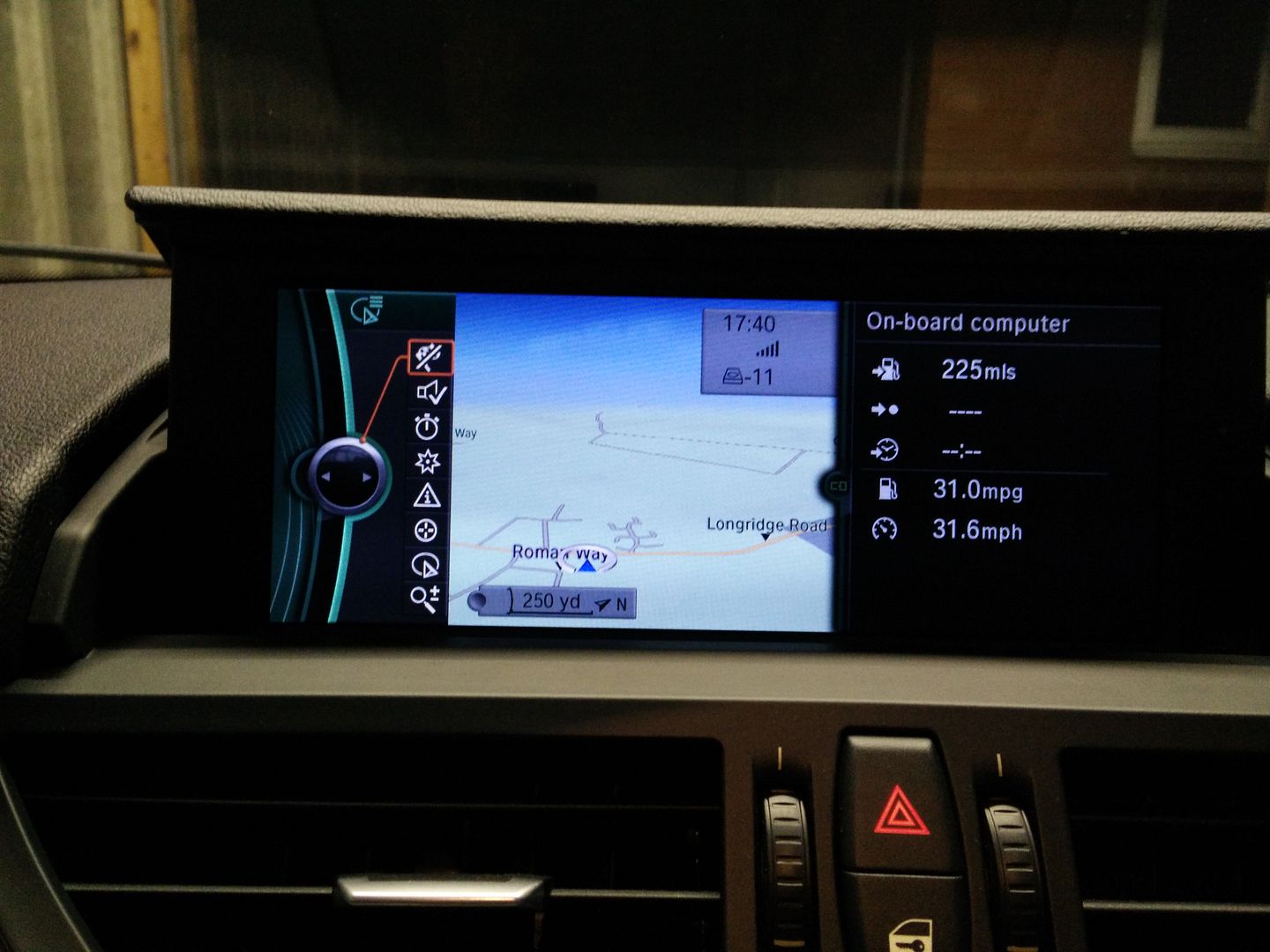

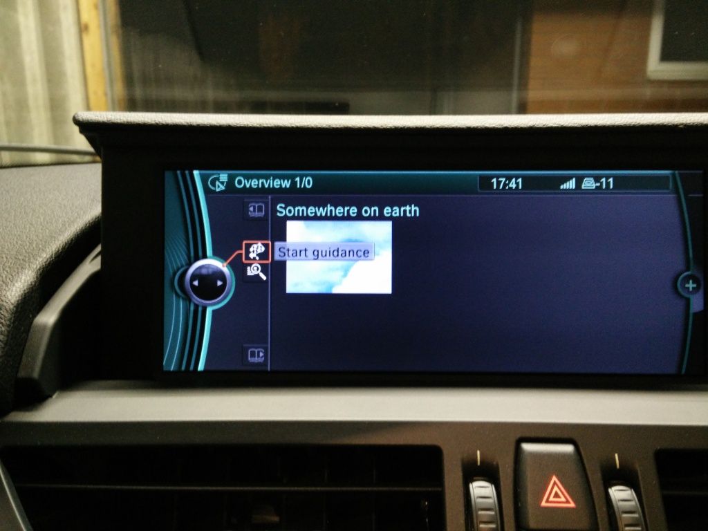

After importing your file select it and then start guidance
