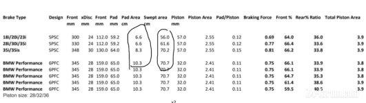

For which BMW model are they originally for ?
E82/E87/E90
How do they compare with the stock brakes that come with the 35is ?
Here you go..
https://www.dropbox.com/scl/fi/f23ccya8vi3ll9ubvqy3g/PB-brake-calcs.pdf?rlkey=pkcsnoyykt8i0gzmgg95yen0z&st=kh49mcyx&dl=0
Here you go..
About the same. No particular improvement. Meh.
Here you go..
For a 35is not an obvious significant improvement on paper…however..a key determinant is ‘compliance’..that’s the technical term for ‘give’ in the brake systems…single piston sliding calipers inherently have a high degree of flex or compliance …a monobloc opposed piston design will have much less flex..therefore ..even if there were no other changes the ‘feel’ of the brake pedal will be more positive and there will be better feedback and the ability of the driver to modulate the brakes will be improved..
Moreover the increase in pad area will help modulate braking as the bigger pad won’t change fractionally as much as a smaller pad..
On the 35is I used them they were markedly more progressive than the stock set up..
For a 23i it’s a big change in pad area, swept area so increased benefits will apply there..
Plus the stock calipers just look pathetic…
