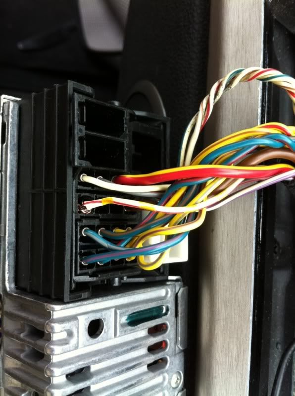

I need help please: just took out the iPod cable and put everything back and the cd player is not turning on!
1 of the metal clip things is a bit chewed up though from when I couldn't get it out, I had to rewire the 3 coloured cable and slot it back in but still won't work! Anyone know where I can get a new metal slot thingy from and also does this look right?
The connection to the back of the radio is audio only, it won't have any effect on the CDC powering up. Check the 3 pin connector to the CD Changer and the fuses.
coming to think of it i forgot to disconnect the battery and the 3 wires touched each other and fumes came off them!!
do you think this would blow a fuse then?
sorry. it was the 30 amp fuse that blew! cant believe the bmw dont come with spares!! need a trip down to the shops :headbang:
